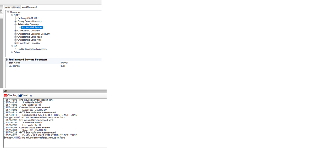

I am trying to set some services as secondary.
When the client sends the "Find Included services" I don't see any events on the STM32WB55 side.
The logs from client indicate:
[18:57:40:898] : 'Find Included Services' request sent
[18:57:40:898] : Start Handle: 0x0001
[18:57:40:898] : End Handle: 0xFFFF
[18:57:40:899] : 'Command Status' event received
[18:57:40:899] : Status: BLE_STATUS_OK
[18:57:40:911] : 'GATT Error Notification' event received
[18:57:40:911] : Error Code: BLE_GATT_ERR_ATTRIBUTE_NOT_FOUND
Error: gpm.M1010: Find included services failed. Attribute not found
I checked and the STM32WB has a secondary service at handle : 0x0012
and its 2 characteristics at handles: 0x0013, 0x0015

I don't, can you please elaborate on step 4).
What are the parameters of the command?
