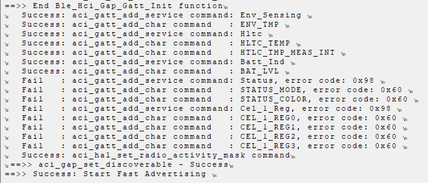

in now configured my 5th own service and encountering the following log output
i saw in the code that error 0x98 means BLE_STATUS_OUT_OF_MEMORY.
after some recherche this leads me to the assumption that the gatt db size may be too small for my needs.
now my question: what possibilities do i have to get my BLE configuration into this module.
i tried increasing CFG_BLE_NUM_GATT_SERVICES, CFG_BLE_NUM_GATT_ATTRIBUTES and CFG_BLE_ATT_VALUE_ARRAY_SIZE but i can not add the desired services.in some cases the module does not even start.
