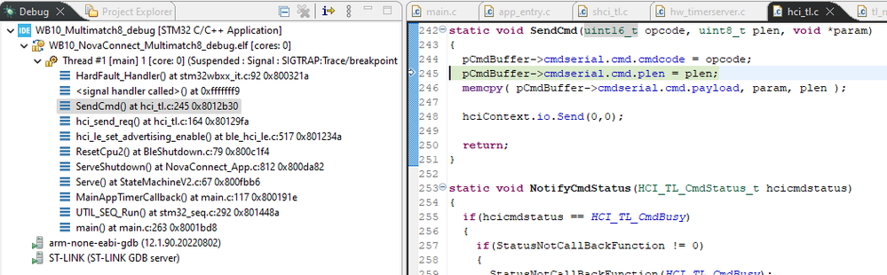

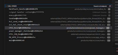

Below is a screenshot of the stacktrace and the line that causes the hard fault.
I suspect this is caused by my code not doing something the way it should, but I cannot figure out what it should do, or when.
