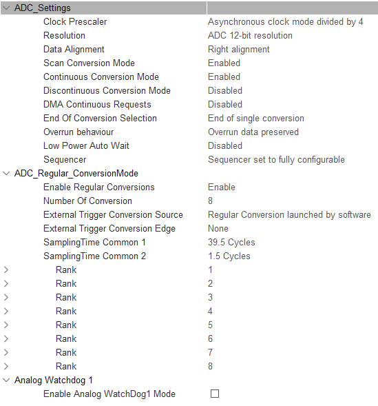

I am developing a small module with the STM32WB10 and I need to do 10 ADC conversions (9 external and the internal temperature).
However, I can only get the DMA to do the 8 channels configured in the regular channel ranks (Number of conversions = 8 is max in the CubeIDE configurator).
How do I make the DMA handle the last 2 channels aswell? if it is at all possible?
I can see in the stm32wb10xx.h that there is this define
#define ADC_SUPPORT_2_5_MSPSthat prevents the stm32wbxx_hal_adc.h from providing more than 8 ranks for the ADC, but I don't need 2,5MSPS. Is it possible to slow it down somewhere? I tried just giving it a slower clock, but that didn't do the trick...

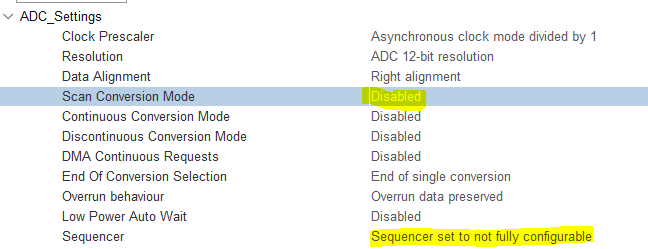

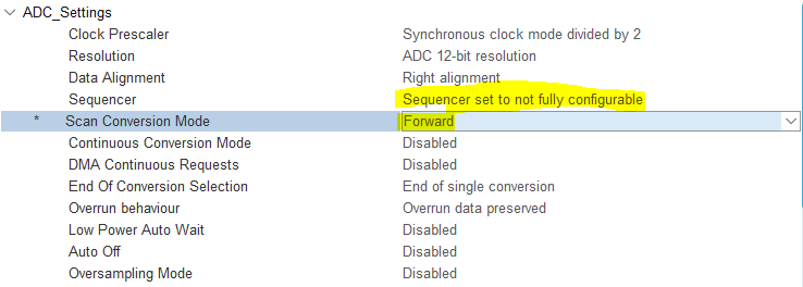

Nevertheless I observed a bug on cube MX. Normally to config and set the ADC as not fully configurable. The user needs to select to set the sequencer as "Sequencer set to not fully configurable" and after selects the direction of the scan in the "Scan Conversion Mode" like in STM32G071RB cube MX:
But in the STM32WB1x when the user sets the sequencer as not fully configurable, the scan conversion mode stays stuck at "Disable".
Thus when you generate the code. Normally in the ADC setup function (static void MX_ADC1_Init(void)) you should have this line :
hadc1.Init.ScanConvMode = ADC_SCAN_DISABLE;Then to activate the scan you just need to replace ADC_SCAN_DISABLE by ADC_SCAN_DIRECTION_FORWARD or ADC_SCAN_DIRECTION_BACKWARD following the desired direction.

Hello @Ugilten ,
The STM32WB can only scan 8 channels when the sequencer is set as fully configurable. If you want to scan more than 8 channels you need to set the sequencer at "not fully configurable".
It's explained in the part 15.3.8 Channel selection (CHSEL, SCANDIR, CHSELRMOD) of the RM0478 rev4.

You don't need to implement the scan mode by your self. There is a reference in cube Mx. As I said in my previous message. If you want to scan more than 8 channels you need to set the sequencer as "Sequencer set to not fully configurable". This option is present on the ADC parameter settings.
