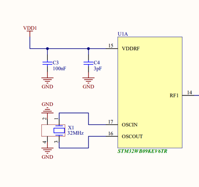

For the crystal connection to the microcontroller, I based it on the same configuration used in the Nucleo-WB09KE (NUWB09KE$CR1), which does not include any capacitors. Here's an image of the schematic according to ST:

Oh right, I forgot this chip has internal load caps.
Looks like it's all connected correctly to me.
Still seems like a hardware issue if the same components/code work elsewhere.
