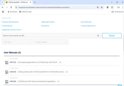

That should be answered by looking in the HAL User Manual for the STM32CubeWB0 software package.
But there is no full User Manual listed - just a Getting Started guide:
https://www.st.com/en/embedded-software/stm32cubewb0.html#documentation
@STTwo-32 - where is the full User Manual?
