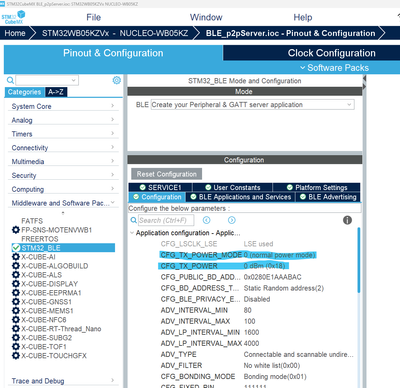

A New NUCLEO-WB05KZ come with the P2P server example code that set the TX Power to 0dBm:
Best Regards.
STTwo-32

2025-03-19 1:14 AM - edited 2025-03-19 1:15 AM
Best Regards.
STTwo-32
