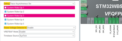

But there are correctly set as you can see:
