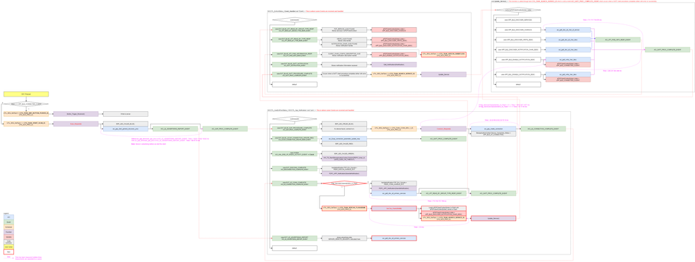

This is done in the BLE_p2pClient_SerChaDiscBypass example code attached. This example is based on the BLE_p2pClient example. Below is the Program flow for the scan/discovery/connection process which starts with SW1 being pressed:
Other files attached:
As you can see on the algorithm, the connection time from Connect_Request() to aci_gatt_write_char_desc is reduced from 1800ms to 60ms when Flag_ServicesCharacteristics_In_Flash == 1. That is when the Services and Characteristics were stored in Flash and the discovery ACI aci_gatt_disc_all_primary_services and aci_gatt_disc_all_char_of_service are bypassed.
Moreover, stopping the scan once a server has been detected instead of waiting for it to timeout reduces the scan time from 10042ms to 50ms.

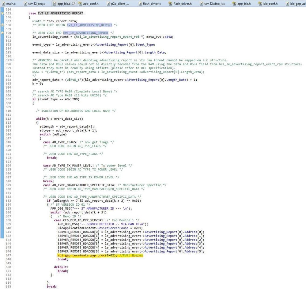

As shown on the algorithm above, I modified case EVT_LE_ADVERTISING_REPORT: in SVCCTL_App_Notification to terminate aci_gap_start_general_discovery_proc as soon as any server is detected, thereby not waiting for the 10.24s hardcoded timeout (which is observed as a 10.42s delay). A condition could be added to check the SERVER_REMOTE_BDADDR against a previously stored address. (Would have been stored in flash in a similar manner to storing the services and characteristics). The stored address could even be potentially used to directly connect and skip the scan.

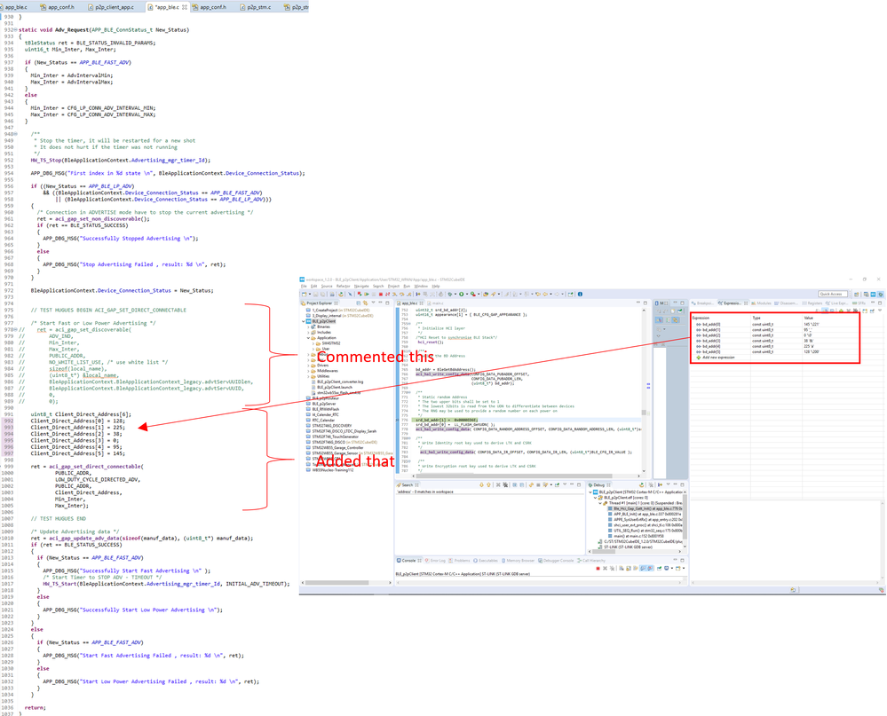

In order to implement Direct Connection we must modify the BLE_p2pServer example to use aci_gap_set_direct_connectable. Yet, I haven’t managed to do so and the division told me it wouldn’t lead to a faster reconnection time.
If you do still want to try and implement it, you could try the following:
Note that the only LOW_DUTY_CYCLE_DIRECTED_ADV (0x04) can be used for the Directed_Advertising_Type argument of ACI_GAP_SET_DIRECT_CONNECTABLE.
Moreover, bd_address and initiator_addr must be swapped: if bd_address=0x333333222222, initiator_addr=0x222222333333.
FYI, when I tried implementing ACI_GAP_SET_DIRECT_CONNECTABLE, I was never able to observe a HCI_LE_CONNECTION_COMPLETE_EVENT despite the AN5270 saying it should be triggered.
