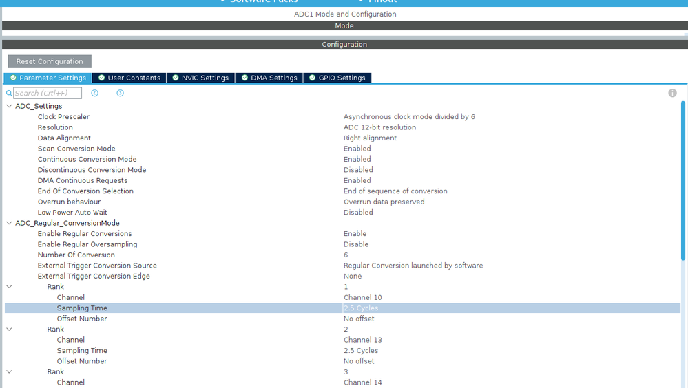

I'm using multi channel ADC with STM32WB having DMA activated
My issue is, every time when i perform the power ON reset, at the same time the channel sequence getting change!
It means, the conversion buffer in HAL_ADC_ConvCpltCallback function sequence is getting change
I have verified the same thing manually by connecting the 3.3V & GND at the particular channels
For example, when i connect the 3.3v at PC4 then the allocated buffer variable shows 4096 samples. However when i do the power on reset then some different buffer shows the value 4096
I have activated the 6 channels here with DMA
I have shared ADC initialization code snippet here
Can any one help me here ?
All suggestions & comments welcome
Thanks

2021-10-19 6:12 AM
I don't think there's an issue in the code you've shown. I would imagine there's a bug somewhere else, perhaps in how you're calling HAL_ADC_Start*.
Note that 6 samples don't fit evenly into a buffer of 4096.
2021-10-22 4:04 AM
Hi.. @TDK
Thanks for your feedback
You're right!
Actually, I'm using the BLE Stack to send the Analog sensors data to android app with custom GATT services
I was triggering the DMA of the ADC when user start the services from the app and stopping it when user stop the services
The issue with the stop api that i was using previously
Instead of the stopping the DMA, i was stopping the ADC by calling HAL_ADC_Stop
So, when again user trigger the GATT services from smart phone then,, HAL_ADC_Start_DMA calling which was failing as the ADC engine went off from the previous cycle
Adding the HAL_ADC_Stop_DMA api to stop the adc has been solved the issue
However, one strange thing that i have Noticed here,
When i changing the ADC voltage of the one channel then, it's also affecting the very next channel !!
Normally, the very next channel show 340 samples at open circuit condition, however when i touch to the 3.3V to the previous channel at whom i need to sense, it's affecting the next channels from 340 to above 1000 !
Any advice ?
Thanks
2021-10-22 7:10 AM
You shouldn't see that much variation. Is the channel floating or at a very high impedance? What happens if you directly ground it?
The ADC has a single sampling capacitor. For higher impedance sources, increasing the sampling time can help.
2021-10-23 5:06 AM
Hi.. @TDK
All the channels are floating expect the channel that I'm testing with 3.3V
However by connecting the GND to very next channels shows the batter result
The near by channel floating between 0-1 samples
I got your point
Thanks for the Reference pdf
For now, all the issues have been solved
