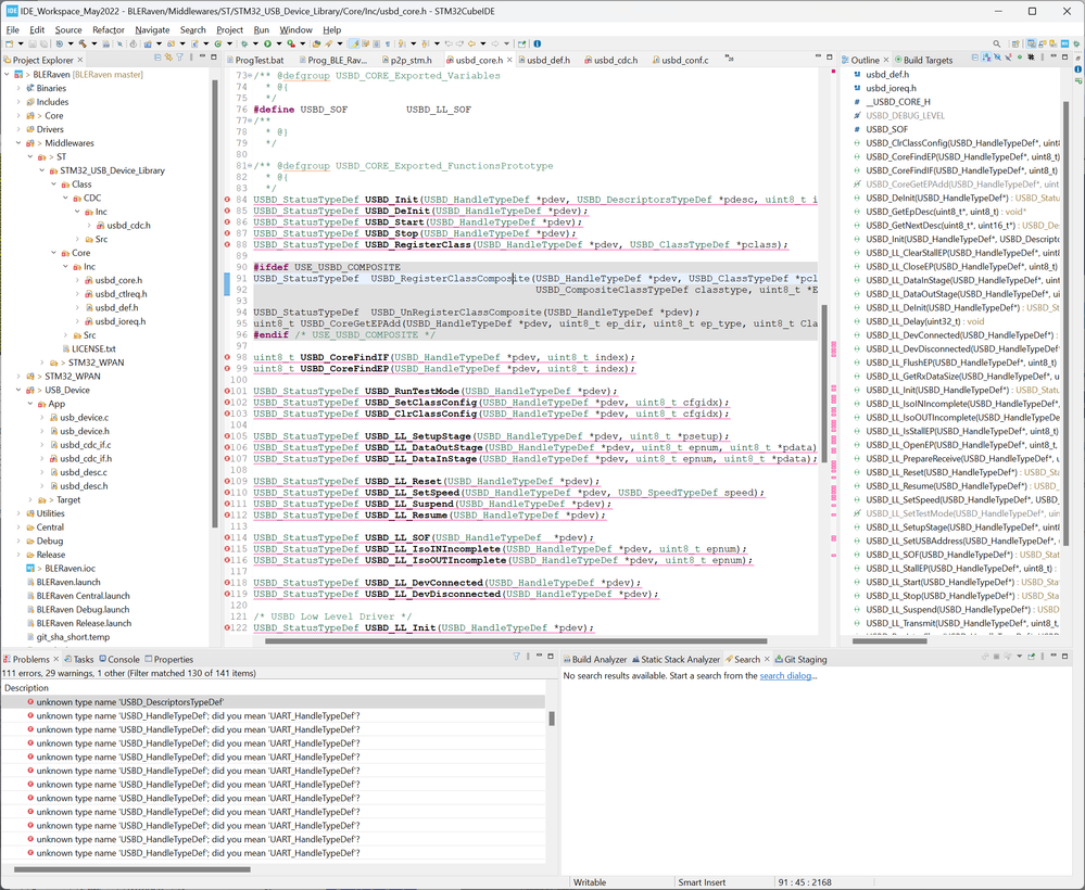

One of the biggest offenders is shown in the image below.
All of the USB device types from usbd_def.h are not getting recognized by the compiler, even though usbd_def.h is in the include list at the top of the file in this image, and I can control-click to any of these structure definitions to go right to the defnition in usbd_def.h. I'm stumped about how to fix this. I have tried refresh, clean project and restart the IDE.

The new version of usbd_conf.h added an #include "main.h" that wasn't there before. After I commented that out, the USB compile errors went away and the compile error count went from 229 to 19. Some of the remaining errors are in the auto-generated p2p_stm.h file because "ble_types.h" was not included. I added that include in, and I'm down to 14 errors, mostly in my own BLE app. I added in #include "tl.h", and that fixed the rest, and I can now compile.
The problem is that now when I re-generate code, the #include "main.h" gets added back in, and #include "ble_types.h" gets taken back out of the p2p_stm.h file, and I'm back to 222 errors. Is there a trick I'm missing?

I'm back working on this again, and I went to see why adding in main.h to usbd_conf.h would hurt anything. I looked for any user-added defines in my main.h that are usb-related, and I found that I had an #include for usbd_cdc_if.h. Once I commented that out, it fixed my USB errors.
For the ble_types.h problem, I see that it's because I include "p2p_stm.h" in the user code area of main.h. I put an #include "ble_types.h" just before it, and that fixed that set of problems.
It turned out that my USB receive buffer was defined in usbd_cdc_if.h, which is why I originally put it into main.h. It still causes hundreds of compile-time problems if I put it there, so I put the include in main.c instead, so that any other USB definitions would have already happened. Now my project compiles entirely without error.
