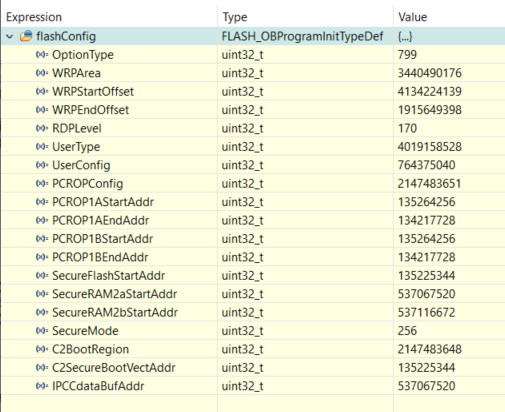

The error occurs with different boards and different registers and can be repeated unambiguously. The HAL_FLASHEx_OBGetConfig (standard) can be found in the attached picture.
