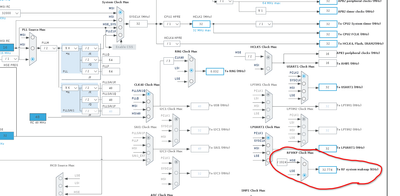

I experienced the same issue. Just mentioned in this post https://community.st.com/t5/stm32-mcus-wireless/stm32wb-cpu1-stuck-waiting-cpu2-at-init/m-p/580103#M16082, the problem is caused by that, the clock of the application is configured on the HSE and the bootloader is on LSE for the RF system wakeup. So configuring the clock source of RF system wakeup to LSE in your application is a way to solve the problem.
2023-10-24 7:22 PM
Holy smokes dude, that was it! Thank you so much! I've been banging my head against the wall for so long.
For everyone else, just to be clear, here is the setting in CubeMX that needs to be modified (must be LSE, not HSE):
