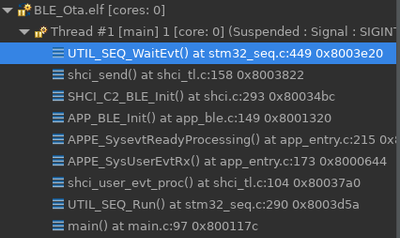

2023-07-15 7:29 AM
So when I issue the reboot command and it jumps into the OTA app, it seems to hang here. It's just idling waiting for an event it appears, so it never exits SHCI_C2_BLE_Init(), which means it never makes it to Ble_Hci_Gap_Gatt_Init(). Is this a bug in the OTA app or does this mean I haven't commanded the reset correctly somehow?

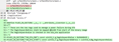

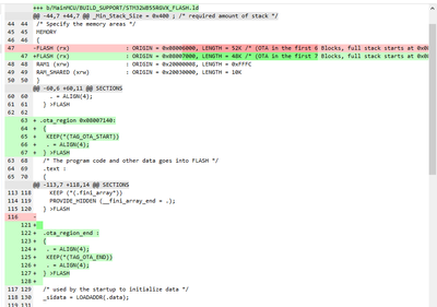

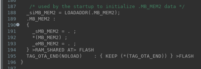

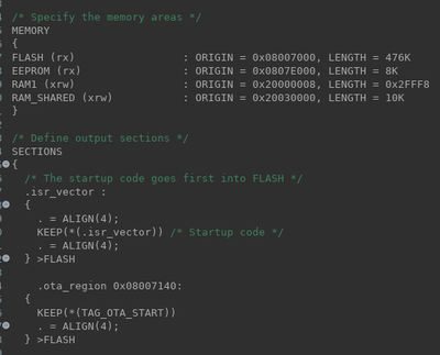

What is missing from your description and probably also from your code is the magic number used by the OTA application to verify that you have a good Firmware.
2023-08-07 8:12 PM
2023-08-07 8:25 PM
While I'm at it, here's the relevant sections from other parts of the code as well:
