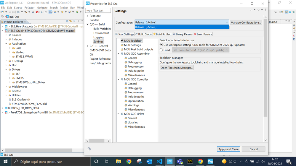

2022-04-28 10:25 AM
Hi EJOHA.
I can't debug the BLE_OTA project, I noticed that there is no build option for debug, how do I get the project to be built in the debug version?

I am facing the same issue, when debugging the application BLE_ota (for STM32WB55) I get the same error as previously mentioned.
No 'DEBUG' version is available from the example project only the 'RELEASE' version.

2024-09-12 10:45 PM
Problem resolved by setting up of Debug Build Mode
Steps:
- Make a new Build mode based on Release (only one excisting)
Build Configuration > Manage > New
- Properties > C/C+ Build > Settings > MCU GCC Compiler > Optimization
Optimization level: Optimize for Debug (-Og)
- [...] > MCU GCC Compiler > Debugging
Debug level: Maximum (-g3)
- [...] > MCU GCC Assembler > Debugging
Next set the debug flag in app_conf.h:
#define CFG_DEBUGGER_SUPPORTED 1
