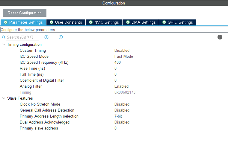

I tried to set STM32 as the master and adafruit feather ESP8266 as the slave. They are going to communicate through I2C. Below is the configuration of the i2c3 because it is the only port for external sensors:Then I write below code for master STM32:

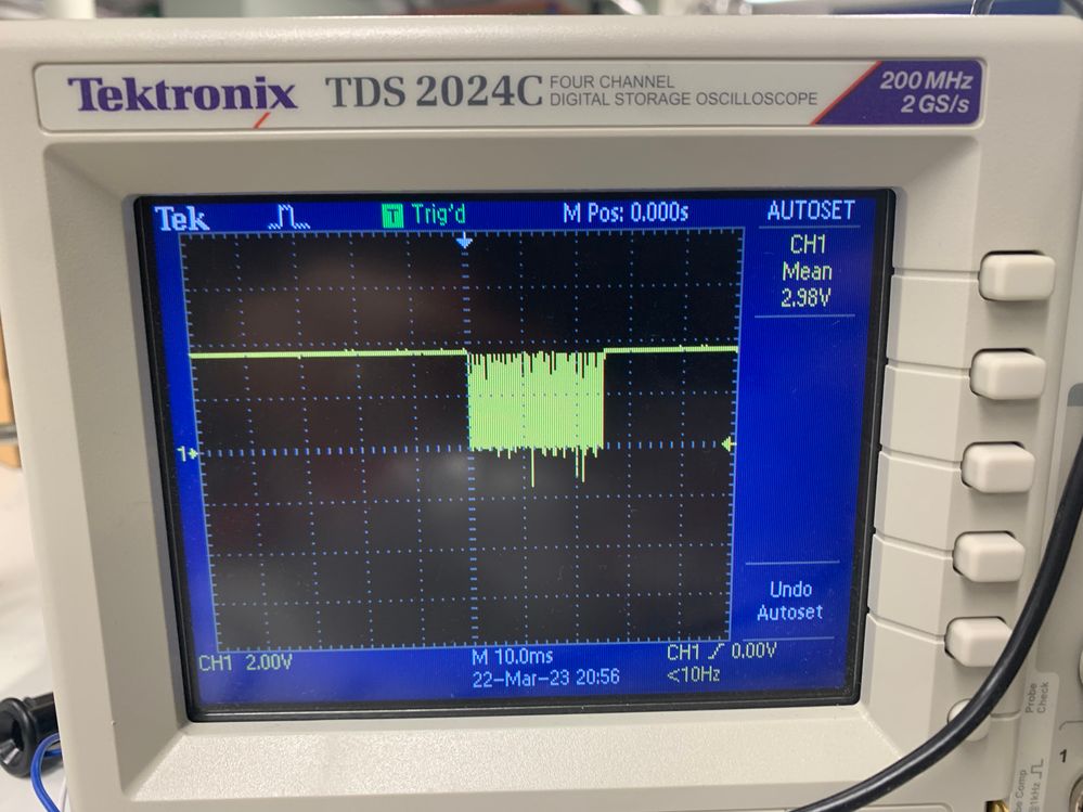

}All I got is `HAL_ERROR`. But I can receive something on SDA (so as SCL):
For hardware connection, I connected two 10k pull-up resistors to SDA and SCL. Did I do something wrong? I really appreciate any help to this problem !!

Hello @QQian.1 ,
Please check the error flags set in the status register and try to get the error (HAL_I2C_GetError).
Make sure you are using correct parameters for this function HAL_I2C_IsDeviceReady().
