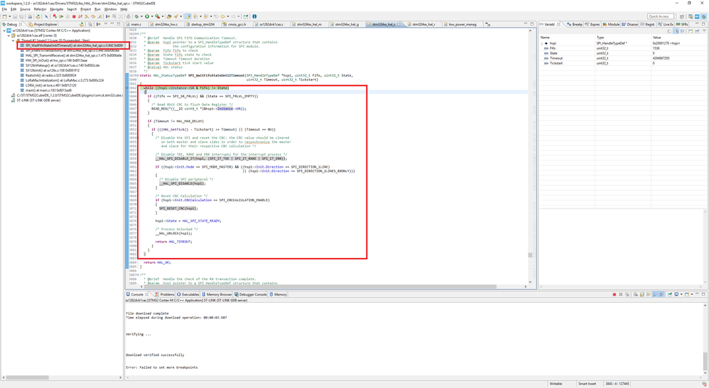

Iam close (i guess) to get the End_Node example "sx1262dvk1cas" working on my custom board. iam going step by step through the whole source code and now the debugger gets stuck in a while loop. anyone knows what i supposed to do here to get rid of this infinity loop?
The var "Timeout" never changes (always on his max value 0xFFFFFFFF) therefore there is no escape from the while loop... neither i don't know where "Timeout" is getting his value
