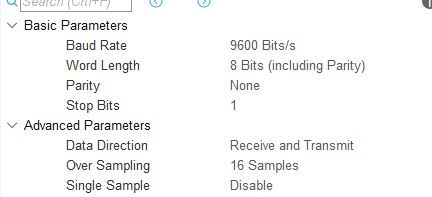

I've been trying to make connection with STM32F0 Discovery and hc-06 bluetooth module via USART2. I've configured Discovery as shown on figure below. Additionally there is an nvic interruption. Hc-06 is configured the same way as Discovery.
