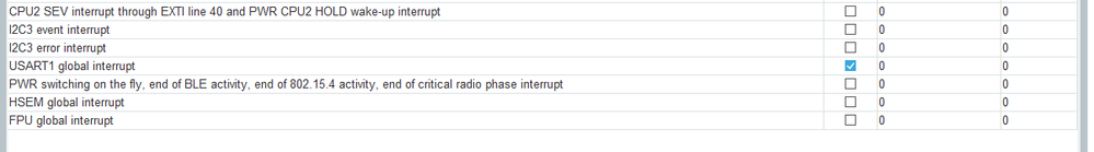

CubeMx 4.97 shows the IPCC interrupts. Is CubeMx 5.1.0 set the interrupts automatically. I did not see the interrupts.

Hello, I will use the STM32WB55 Hands ON 2 with the new CubeMx step by step.
