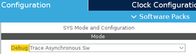

in the .ioc file I'm not able to see the debug option in sys section

For the Debug option, is available on the .ioc file under the category "Trace and Debug".
