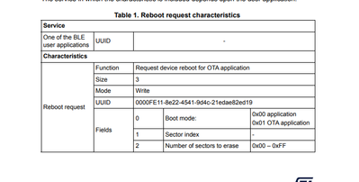

I have another problem. I made it as an OTA application and when I upload BLE_OTA application on my board, I am able to flash my firmware once. However, I don't understand how can I reboot my system and turn back to BLE_OTA partition from my application partition. I need unlimited firmware update continuously.
In here you can see the reboot characteristics. I create one but what should I add to my code to activate it in document it is not explained well and detailed. Could you help me with it?
