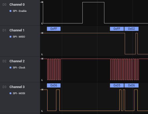

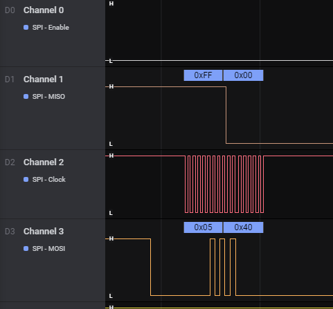

According to Datasheet of CAT25320 I first sent command to RDSR register and got 0x00
According to which BP0 and BP1 defining no protection and WEL is disabled and Device is ready
Then i sent WREN command 0x06 and again checked status register and received 0x02 which is means WEL bit is enabled

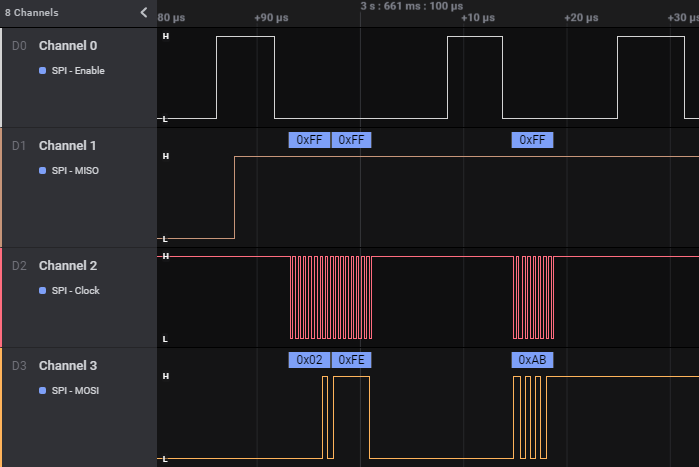

On the last picture, write operation. There must be 32clock pulses. 8bits OP code, 16bits adress, 8bits data, but you have 40 bits (0x02, 0xFE, 0x00,0x00,0xAB)

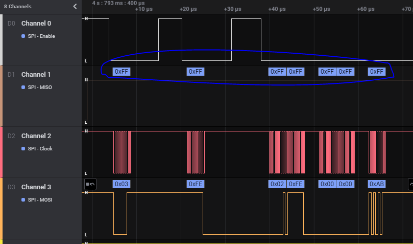

Sorry there was a mistake I forgot to put this image this one is for EEPROM Write command can you guide me what i am doing wrong
I am using eeprom first time for spi
2021-08-26 9:36 AM
There is only 24bits, on the picture and CS goes high in the middle of the operation.
You must set CS low, send op Code 0x02, high byte of adress 0x0F, low byte of adress 0xE0, one byte of data 0xAB and then set CS to high. After that, you should check RDSR register, busy bit. Operation is finished, when RDY bit is low. Or, you can wait some time (write time cycle is aprox. 5ms)
2021-08-26 11:17 AM
Your waveforms don't match those in the datasheet. CS cannot be toggled mid-transaction.
