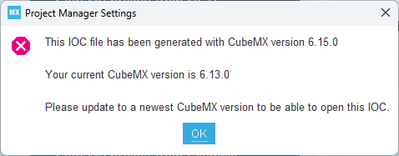

2025-08-12 7:05 AM
I tried installing an older version of STM32CubeMX and I get this error:
I guess there's no going back now :(.
Kindest regards.
