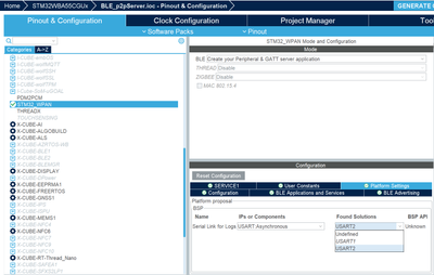

with the BLE_p2pServer example for STM32WBA55, i want to change the interface from USART1 to USART2. How can i use the trace information like
with USART2?

Hello @ledi7
To send the trace information to USART2 instead of USART1 in the BLE_P2PServer app for the Nucleo-WBA55CG you have to:
Best Regards.

2025-01-21 3:41 AM
Hello @ledi7
Best Regards.
STTwo-32

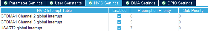

Thanks for the information! It works, but only if BLE is not activated (no advertising, no BLE connection). I use the same settings for USART2 as for USART1 with 19200 Baud. The NVIC priorities are also the same.

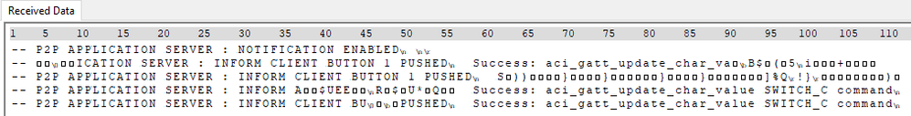

}If no advertising or no ble connection is active, I get the log information (here i send a byte four times via HTerm) without errors:
But when advertising or a BLE connection is active, I usually get confused characters as log information. Here, i also send a byte four times when a BLE connection is established:
