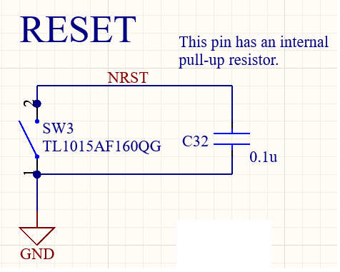

LSI1 is said to be less power-hungry compared to LSE, which is why I would prefer to use it. When I select LSI1 as a source for RTC, I cannot reset the MCU using an external button connected to the NRST pin (only turning the power on and off restarts it). When LSE is used, the MCU operates as expected. In RM0434, it is said that LSI is available in all the above modes.

Please, let me know if I can provide any additional information.0693W00000UohW0QAJ.png
