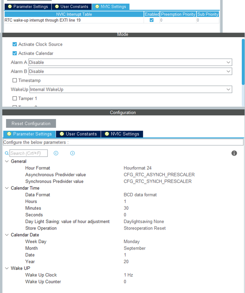

2020-09-12 8:12 AM
I have done all that you have mentioned. Here is my configurations
