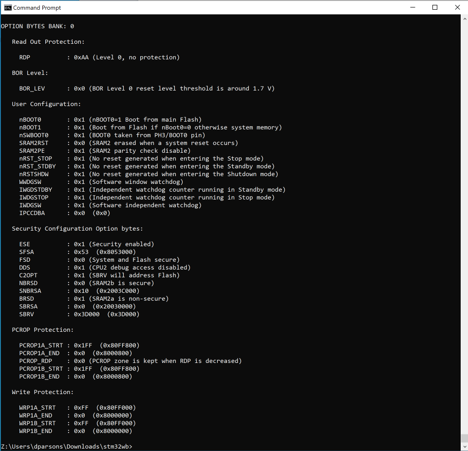

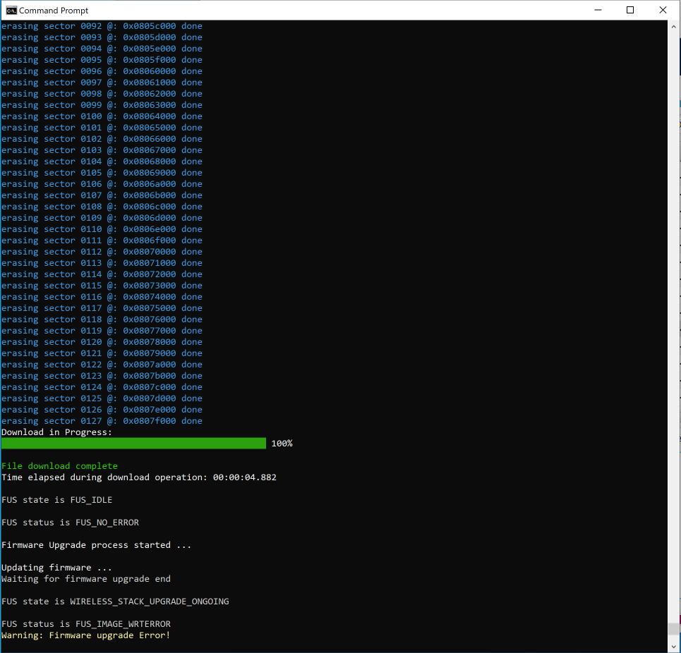

2021-12-20 9:00 AM
Same failure from command line and option bytes...
