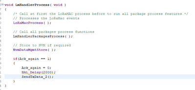

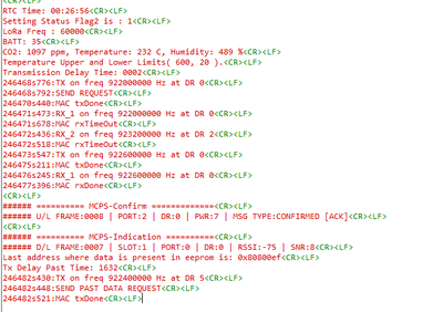

2023-08-24 11:00 PM
Thank you for your suggestion.
This code is working on stm32 sequencer so I am not able to send 2nd packet before the completion cycle of 1st data. If I am doing so my code is getting stuck.
I am sharing the snapshot of log.
I am sharing the code in which I am calling the function for 2nd data transmit.
Please help me out.

2023-08-25 12:06 AM
Hello again,
You should do both transmission in the same function separated by a delay to make sure that the sequencer authorise both transmission. Else, you should modify the sequencer's parameters to execute both functions.
Best regards.
