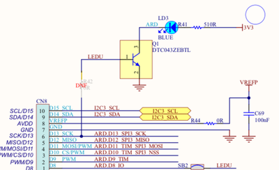

I have a question regarding the STM32WBA55G-DK1 board I have on hand.
On my board, R42 is not populated. Could you please confirm whether R42 is not mounted by default?
R42 is a 0 Ω resistor located on the control line of the general-purpose LED (LD3), and according to the schematic it appears to be mounted.
I would appreciate it if someone could clarify this.

Hello @TYAMA.2
Just a rectification, as you can see on the table 8 of the UM3255, the LD3 is controlled throw the PB15 after soldering the SB2. Also, after fitting the R42, you can use PA0 to control LD3. For the design version, the one available on the market is designed according to this MB1802 version (B01).

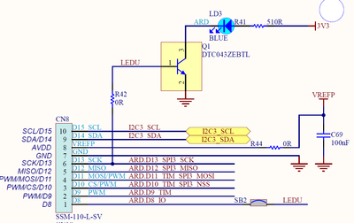

Thank you for your reply.
On the MB1802 board I obtained in the past, R42 was populated.
In that case, from which port is LD3 controlled?
If you could let m
e know, I would greatly appreciate it.
2025-09-02 6:05 PM
Hello, It seems that the schematic you provided was version 1.1, while I was referring to version 1.0. The implemented components were different between schematic version 1.1 and version 1.0. It appears that the actual board has been implemented according to version 1.1. I understand now. Thank you for your help.
