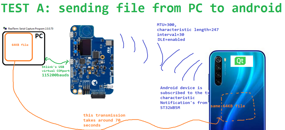

Hi i am developing a BLE-UART bridge with an STM32WB5M.
I am guetting around 1,85 KB/s data troughput, is this normal?
Did anyone pull this off with greater data troughput? (same uart thing or any streaming application)

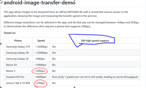

I found out the data trougput depends a LOT of the BLE chipset of the android phone/device.
My phone didnt have BLE5.0 2M high speed support.
Newer i-phones and Samsung phones/tablets would be able to archieve this data trougputs.

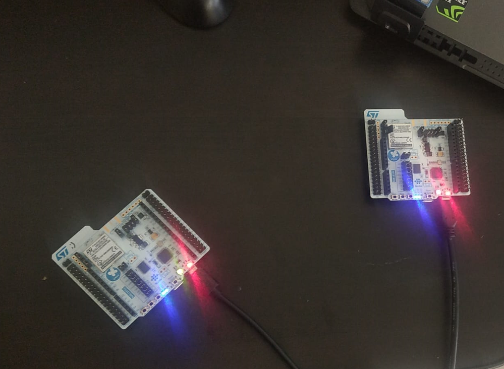

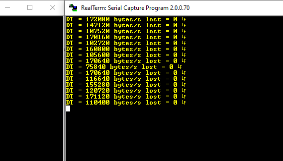

i ran the BLE_DataThroughput example with PHY=2MBs
The terminal says im transmitting in between 170KB/s and 75KB/s.
Those are great news, but now i have more questions
Searching for what data is being accounted for:

}It looks indeed like its the real data troughput
DataTransfered += NotificationData.DataTransfered.Length;

The data throughput is smaller with an Android device than between two STM32WB because the smartphone choose the connection interval and the CE length. The peripheral can request a new connection interval (the smartphone can accept it or not) but it can't modify the CE length. You can use ST BLE Toolbox application, that allow to do data transfer measurement (uplink and downlink).
