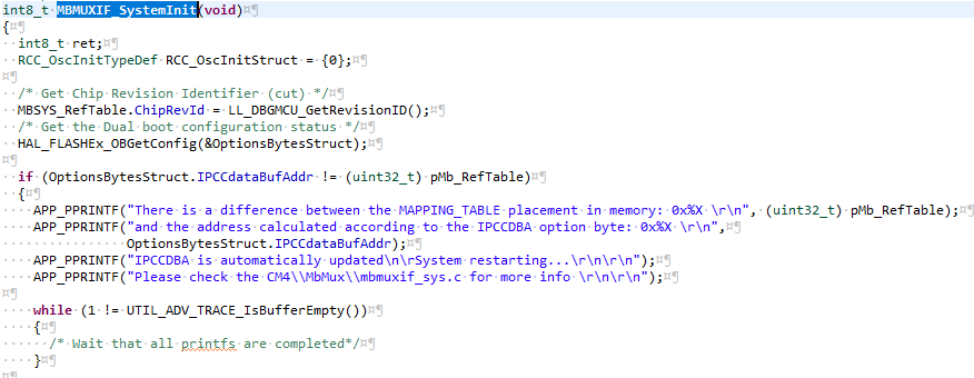

I try to delete static et const and its start to work. But Now when I add more datas (bitmap images) It's planting when a restart occured, When the programm check refTable validity
I assume that the reserved memory for CM4 is too small for this kind of data and that its righting over CM0+ Datas...
How can I change memory mapping ?
