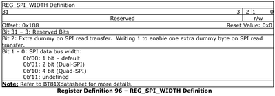

I'm using the Riverdi RVT50HQBNWC00-B display which contains the BT817Q EVE4 chip. I currently have the display connected to the QUADSPI port of the Nucleo-WB55RG board. I was trying to confirm that I could "talk" to the display by getting the ChipID. Once that connection is made, then I need to set the REG_SPI_WIDTH to tell the chip to operate in Quad SPI mode. I think this is going to be a very difficult task.

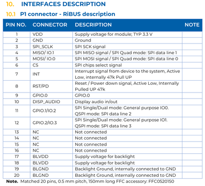

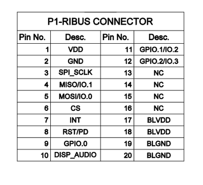

I currently have it connected per the Riverdi DS:
I initially was trying to get single mode running because the CMD section is only accessible through single spi and then I was going to switch it to Quad SPI and get that working. But yes, I agree, trying to get this to work has become a time suck and as you said, running it via QSPI doesn't really buy anything. Thank you for pointing that out.
