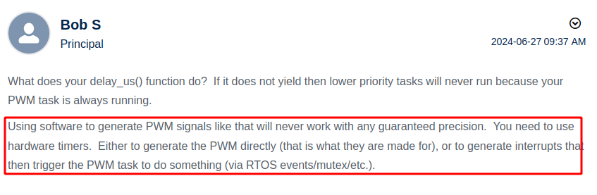

2024-07-11 8:39 PM
What does that mean? Fix it in CubeMX and re-gen the code. Or hand-edit MX_TIM2_Init() as a quickie test and THEN fix it in CubeMX.
> I modified the prescaler value to the 31 later still its not fixed the issue
WAIT - You are using TIM2 as BOTH the us delay and a PWM generator?????? NOOOOoooooooo....... First off, as @Tesla DeLorean said, don't (ever) clear the timer count value. And second, even using differential timer counts, this will fail when the timer auto-reloads from its ARR value to zero (which is has to do in order to generate the PWM). Use a different timer exclusively for your delay function, **IF** indeed you still need that us delay.
> In first reply of this thread you suggested me to use hardware timers or interrupts i used hardware timers to genrate the pwm signals in sync without phase shift but its not given expected results there is an phase shift between timer1 and timer2
2024-07-12 10:08 AM
If you set TIM2 prescaler to 31 in CubeMX, then re-generate the code (from CubeMX), then rebuild your code and run it. As long as your code never writes to TIM1 or TIM2 after starting the PWM outputs, then the phase relationship between TIM1 and TIM2 should never change.
You should also be able to write to the CCRx registers to change the PWM duty cycle without changing the phase between the TIM1 and TIM2 signals (I believe you had "output compare preload" enabled).
However, if you ever write to TIM1->CNT or TIM2->CNT you will break the phase relationship between the 2 timers. Likewise if you change the ARR values in either timer you MAY break the phase relationship. The only way to update the ARR regs and keep the phase relationship is to have "auto-reload preload" enable in both counters and you GUARANTEE that you update the ARR value for both timers in the same PWM period (i.e. before both timers roll over to zero again).
If you still see a changing phase shift, create a minimal program that only starts the PWM and does nothing else. Do you see the changing phase shift with that program?
