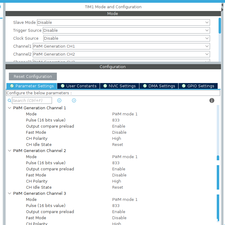

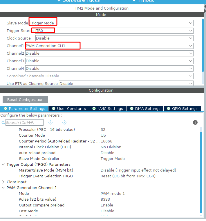

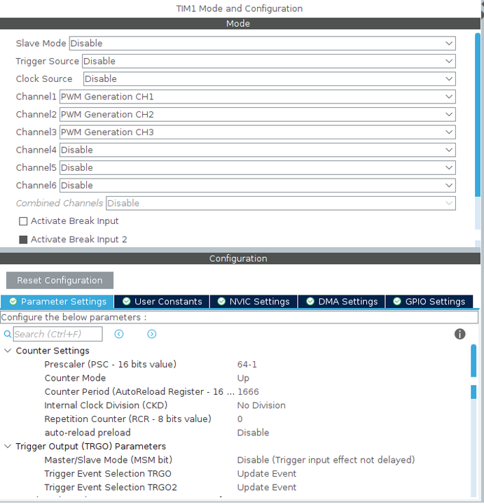

}2.I used the hardware timers directly to generate the PWM signal But there is phase shift after two or three pulses
Below is the configuration for PWM using slave trigger concept.

The phase shift between the timer1(three channels ) and timer2 singlechannel

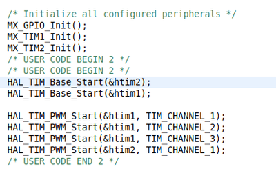

A)Yes i am starting the timer base once and PWM like below
I am attaching video FYR

Your TIM2 prescaler needs to be 31, not 32. See how you set the TIM1 prescaler (64-1). The actual clock divisor is "precsaler+1".

Hello @Bob S ,
Does it mean that changing the prescaler to 31 will make it work? I modified it later, but there is still a phase shift between the two timers' PWM.

What does that mean? Fix it in CubeMX and re-gen the code. Or hand-edit MX_TIM2_Init() as a quickie test and THEN fix it in CubeMX.
WAIT - You are using TIM2 as BOTH the us delay and a PWM generator?????? NOOOOoooooooo....... First off, as @Tesla DeLorean said, don't (ever) clear the timer count value. And second, even using differential timer counts, this will fail when the timer auto-reloads from its ARR value to zero (which is has to do in order to generate the PWM). Use a different timer exclusively for your delay function, **IF** indeed you still need that us delay.
