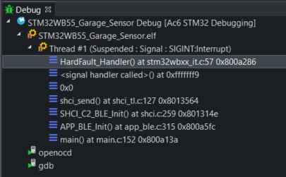

Hi Vyacheslav,
Thank you for your reply. I have tried the following code and it unfortunately results in a hardfault within APP_BLE_Init() that does not occur on 1st call on startup.
if(PWR->SR1 & PWR_SCR_CWUF4)
LL_PWR_ClearFlag_WU(); // Clear WKUP Flags
LL_C2_PWR_WakeUp_BLE();
/* Delay 200ms */
for(i = 0; i < 4800000; ++i);
APP_BLE_Init();
}2019-10-19 3:49 AM
