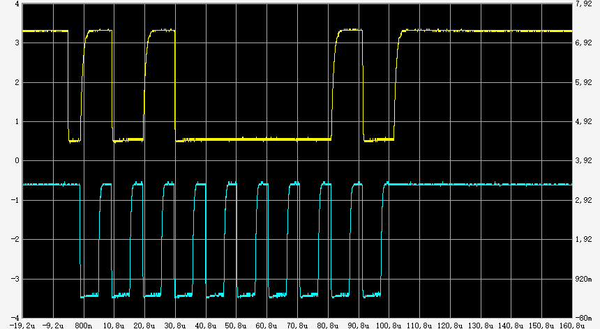

I cheked I2C line and finde that there is only one addres byte without "ACK signal".

Found the answer. Just use the right address number for the right STM32 family.
The document AN2606 have all I2C address per family (my case was 0x56 for STM32G03xxx.)
For the STM32WB55 (as it's the original question), the address should be 0x4F (not 0x50).
The signals are there, but maybe the error is confusing (it should be BRG_TARGET_CMD_TIMEOUT instead BRG_I2C_ERR).
