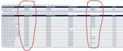

Hello @TWood.4
The USB Dongle is based on the STM32WB55CG. This MCU have 1M of flash so the stm32wb5x_FUS_fw.bin should be loaded at 0x080EC000 and the stm32wb5x_BLE_Stack_full_extended_fw.bin should be loaded at 0x080C5000.

Ah OK. I misread the FUS and BLE Stack release notes.
