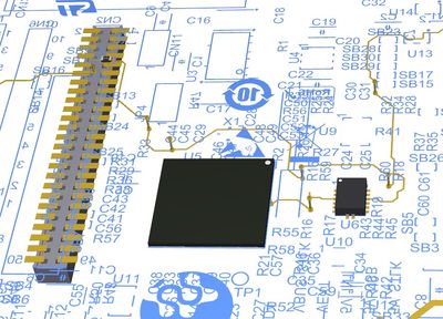

2025-04-19 11:38 AM
And for using via embedded ST-LINK in the board, is it still required?
I ask because the ITM printf isn't working and after checking CAD resources for it.

2025-04-20 2:36 AM
I have used STM32Cube with other boards and it's working well when this board does not, what is the possible reason for it?

2025-04-20 3:00 AM
It's same question, sure.
I think it isn't working beacuse the SB12 that isn't soldered...
As I have seen in CAD files, pin 10 in CN4 connected without SB12:
2025-04-20 7:26 AM
Hello @Arielu
I think it is a miss understanding from my side. You should solder the SB12 so you can use the on board SWO throw the on board ST-LINK.
Best Regards.
STTwo-32
