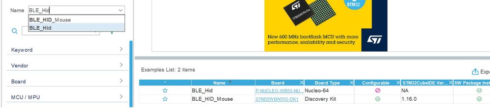

GS2
Senior II
Thank you Alan,
Yes, you are right, I can see STM32WBA55CGUX_FLASH in my example.
But there were only 2 BLE_HID examples for my P-NUCLEO-WB55RG board available.
HID_BLE_Examples.jpgThat why I picked BLE_HID_Mouse, because BLE_HID is not configurable and there is NA STM32CubeIDE version available for it! So what is your suggestion on how to solve this problem?
Hi Alen, also can you tell what should I do now:
I thought that, if there is a keyboard and mouse example, or better keyboard mouse combo, i will be able to modify keyboard example for my custom keyboard and mouse example to make it air mouse. But without those examples I will not be able to do that my development.
Is there any way to find these examples?
STTwo-32
Hello @GS2
As said @Alan PORTE and as I've said me and @Andrew Neil on your previous post, The BLE_HID_Mouse is designed to work on the STM32WBA and specially for the Discovery Board. It is not fully compatible with the STM32WB which is a different series (STM32WBA is not the STM32WB). So, you can't run the BLE_HID_Mouse example on an STM32WB and expect it to perfectly work since there is a difference between both series. Also, for the BLE_HID example, you can run and compile it on the STM32CubeIDE. It is just not based on any .ioc file but write directly to the IDE without CubeMX initialization. So you can use it on the CubeIDE (the picture you shared means that it can work on all CubeIDE versions).
Best Regards.
STTwo-32
