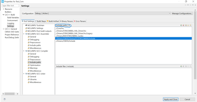

I just try to get a NUCLEO-WB09KE board running.
Unfortunately CubeMX (6.12.0) generates HAL files with a pattern of stm32wb0x_hal...,h but the include paths are stm32wb00x_hal (one more zero!)...
Also in CubeIDE EXTI_HandleTypeDef is not found when compiling.

2024-08-29 6:57 AM
Hello @AWack ,
I am not able to reproduce your issue by creating a project with NUCLEO-WB09KE board.
I suggest that you provide your ioc.File.
Thanks.
Mahmoud
