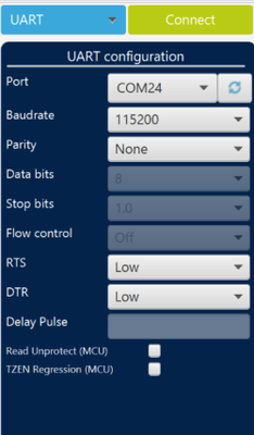

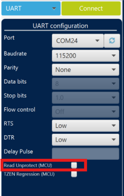

2025-09-05 2:52 AM - edited 2025-09-05 2:52 AM
Hello @Araleb and welcome to the ST Community.
To connect to your NUCLEO-WB05KZ, you should follow those steps:
Best Regards.
STTwo-32
Best Regards.
STTwo-32

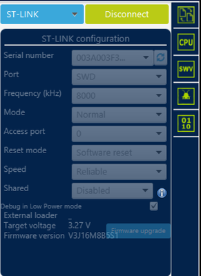

2025-09-06 11:12 PM
Thanks so much, it works perfect.
Please note that before erasing, one must return to ST-LINK PORT: SWD
