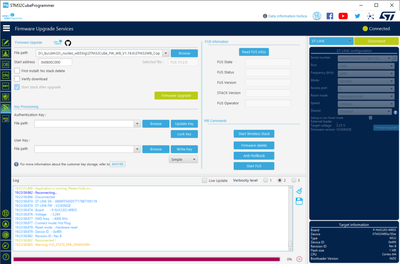

thanks for the quick response. Sorry, but you may haven't fully read my post "Neither firmware deleting nor Firmware upgrading is possible". I tried updating with STM32CubeProgrammer GUI:
and also with the CLI tool (see below). Seems that uploading (1.step of FUS) works but starting the firmware (2.step of FUS) always fails with FUS_STATE_ERR_UNKNOWN.
