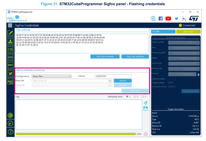

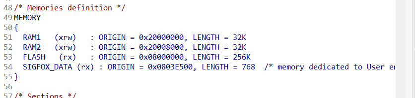

You have to match the address in cube programmer "0x0803E500", and the one written in the STM32WL55JCIX_FLASH.ld file, corresponding to the "USER_Key_region_ROM" variable.
This address is valid for 256k memory, but if you use a different one this value may change.
In STM32WL55JCIX_FLASH.ld :
and in CubeProgrammer :
Let me know if this resolve the issue

I have all the default parameters.
In STM32WL55JCIX_FLASH.ld, I have :
Unfortunately, It doesn't revolve the issue
Best regards
