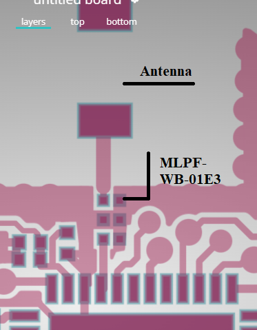

Hello everyone, please help me fix the problem with my custom PCB board and BLE. The antenna on the board won’t work (I don't see my device via Bluetooth) in any way and I don’t know where to look, can anyone implement Bluetooth via filter MLPF-WB-01E3 and antenna 2450AT18B100E on STM32WB? I suspect that there is a problem with the board since I run similar code on Nucleo and I can see the device through my phone but I can't see the device through my phone Does anyone know how to check where the error is, and to check if I designed the board correctly?

If everything else are OK, Even without assembling the filter, you should see the advertising packets on the BLE app. Just set the tx power to max (6dbm = 0x1f).
Assembling the filter part is very challanging. Make sure that all 6 pins of the filter are connected to the boaed.
