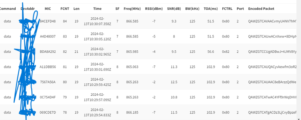

1) In this case I tried filling 6byte and transmit it, at SF7 I'm getting 28 frames per minute=6byte*28frames=168bytes=22.4bps.
2) In this case I tried filling 48bytes and transmitting it, at SF7 I'm getting 27 frames per minute=48byte*27frames=172.8bps.
3) In this case I tried filling 240bytes and transmitting it, at SF7 I'm getting 24 frames per minute=240byte*24frames=768bps. That is also I'm getting frames only at SF7 and SF8 and for the rest of SF I'm getting empty frames. When i try to fill 240 bytes.

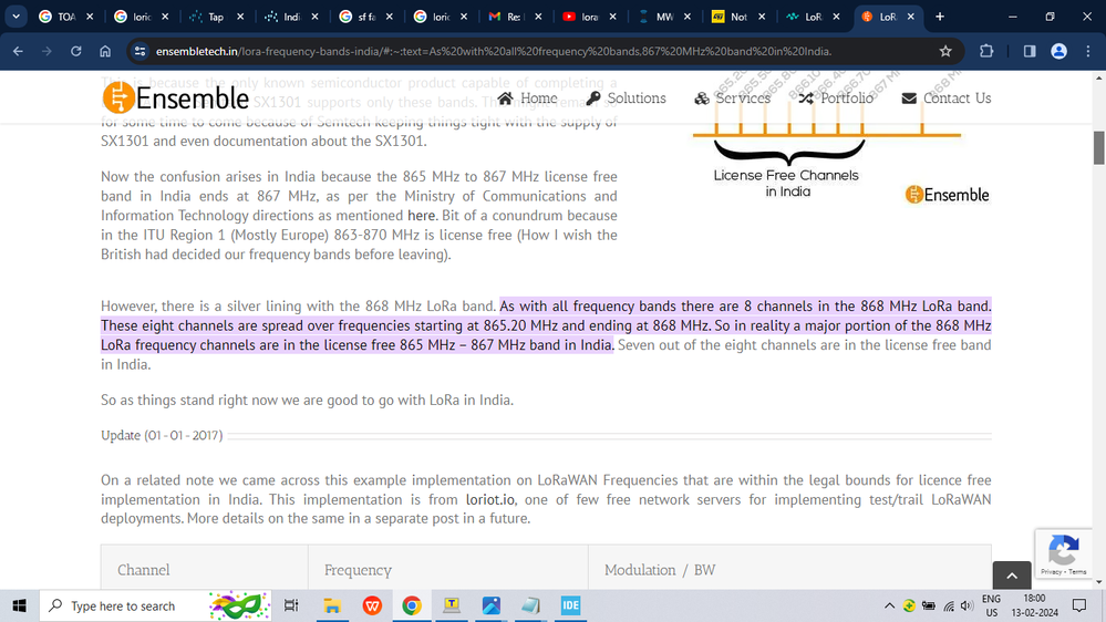

1) You can have either the maximum range or the maximum data rate: I'm Keeping my gateway and node at a 5cm distance then too I'm getting 24 frames at SF7, Which is 768 bps.
2) When it comes to license-free bands: Out of 8 bands, 7 are license-free only. when it comes to license bands. How can I get those license bands?

@Yuvi wrote:I'm Keeping my gateway and node at a 5cm distance
That's probably too close! You're likely to be saturating the receivers.
@Yuvi wrote:How can I get those license bands?
By obtaining the appropriate licence(s) !
That would probably require you setting up as a major network operator.

@Andrew Neil 1) I have tried various distances. But still, the maximum data rate that I'm getting right now is 768 bps.
2) Getting a license band is the only solution?
