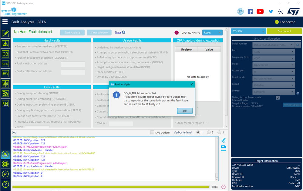

KKIM.6
Senior II
I can see this error also.0693W00000Uo1jxQAB.pngDIV_0_TRP bit was enabled.
What is this? and How can I understand this error and fix it?
Remy ISSALYS
According to UM2237 documentation the Memory Management Fault detects memory access violations to regions defined in the memory management unit (MPU), such as code execution from a memory region with read/write access only. If this fault was triggered by a faulty address, access is displayed on the MMFAR text field.
For the second point DIV_0_TRP allow to enable Usage Fault when the processor executes an SDIV or UDIV instruction with a 0 divider:
  • 0 = do not trap divide by 0; a divide by 0 returns a quotient of 0.
  • 1 = trap divide by 0.
Best Regards
