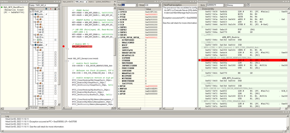

When enabling the MPU I get a a hard fault exception when accessing the SCB->SHCSR Register (@ addr. 0XE000EDF8. See marked line in Dissasembly Windows. The Fault Viewer dumps following message:
The processor has escalated a configurable-priority exception to HardFault.
An MPU or Execute Never (XN) default memory map access violation has occurred on an instruction fetch (CFSR.IACCVIOL, MMFAR).
A derived MemManage fault occurred on exception entry (CFSR.MSTKERR, MMFAR).
Exception occured at PC = 0xa3f36560, LR = 0xf37590
See the call stack for more information.following question:
Q1. How do I give correct access priviledge for Cortex Internal peripferals? (starting @0xE0000000
Q2. I use certain Area of the internal SRAM as DMA Buffer, how which memory attributes are correct for Multimaster access (TEX, C,S,H Bits) and can I even give different attributes for parts of the memory (DMABUF Area) this is located on the same device?

2022-10-05 2:36 AM
Following Image of debugger I got:
