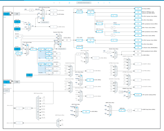

My CubeMX ADC Config
Clock configs:

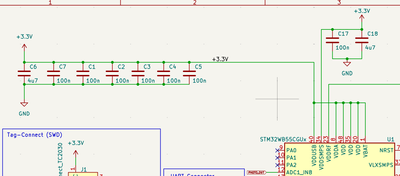

VBAT is connected to a 3V Battery, and all other VDD pins are connected to the same battery since the board is only powered by this battery.

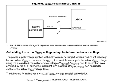

So also VREF+  to the ADC ? Then you always just check the 1/3 divider !
VREF+ has to be at a fix reference level, to check the supply or bat voltage, otherwise the adc-full-reference scales with the applied voltage and you can get no useful info.

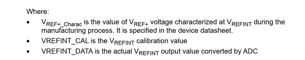

So if leaving VREF+ at VBAT , measure the (fixed) internal voltage and calculate Vbat and Vref from this:
read in rm...

>Where to get VREFINT_CAL and VREFINT_DATA from?
>And what is VREF+_Charac ?
>There is no example in the wide world of STM of how to do this. At least i couldn't find any
Just - did you look at the rm at all ?
The next lines after the Fig.91 (i showed) should tell it
Again : read in rm...

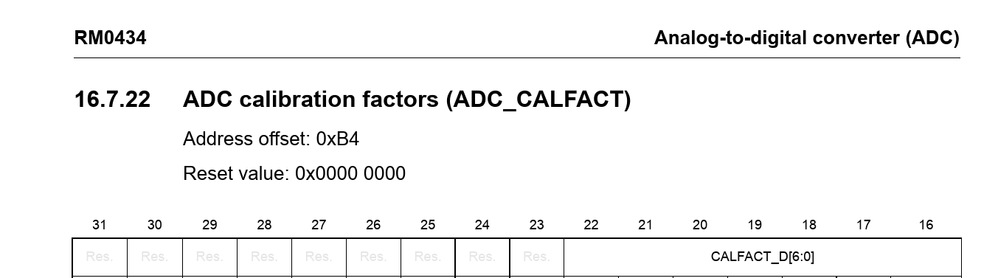

next: see also register descriptions:
So, again -> how to translate this now into code?
ADC1_COMMON->CCR |= ADC_CCR_VBATEN;
uint32_t calfact_register_value = ADC1->CALFACT;
uint32_t calfact_s_value = calfact_register_value & 0x7F;
uint16_t ts_cal1 = *(uint16_t*)0x1FFF75AA; // ???
vref+ = ?? * ts_cal1 / calfact_s_value
// maybe i now have vref+?
// now how should i use it to calculate vbat?
vbat = readadc(bla) * ?? * vref+?
 Is there any documentation / tutorial on the code side of things?
