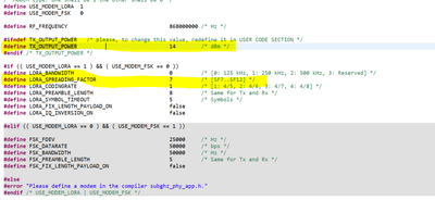

Yes, you can change those two parameters on the "subghz_phy_app.h" file of your project:
