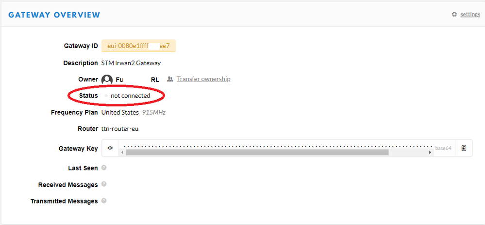

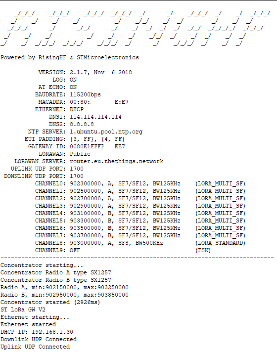

I'm facing a strange problem. I just bought the LRWAN2 package, connected the gateway to the network, one usb cable to power it and one usb to the st-link. I configured the packed forwarder to router.eu.thethings.network,1700,1700 and CH to US915.
On the ttn side, I registered the gateway but it says "not connected".
Searching on the ttn troubleshooting guide I found the bin file for this Gateway, so I updated the firmware, changed the MAC address to the provided one but no connection.

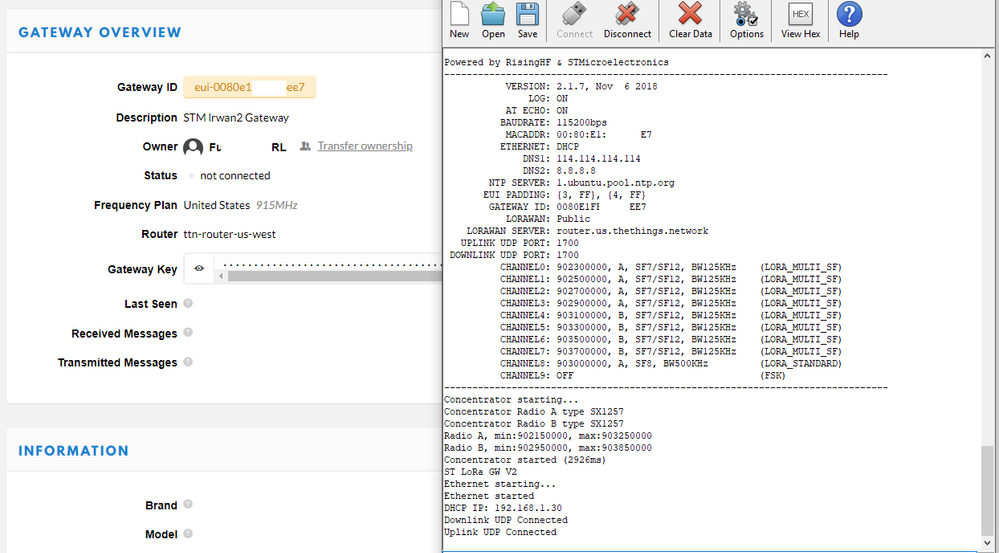

Ok I solved the problem, My device had active the US subBand2 and the Gateway the SubBand1. I Changed the frequency plan on the Gateway. When I sent a message, the gateway came alive.

router.us.thethings.network (America, 902-928 MHz)
router.au.thethings.network (Australia, 915 MHz)
2019-12-18 12:03 PM
Thanks Clive1 for your reply,
I tried both servers but the same luck.
Any other idea?
